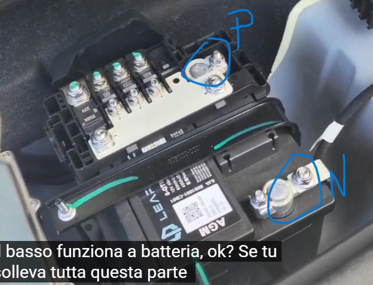

How have you connected the sensor to the battery terminals? Are there any risks for the car’s electronics with the positive [terminal]?
Insert the terminal clamps of the Bluetooth monitor cables under the bolts you can see in the previous photo. To access the battery, you must first remove the boot floor panel and then the polystyrene part (by unscrewing the two plastic knobs that hold it in place).
Thank you for the detailed reply!
So I lift them up keeping them connected, basically, and underneath I insert the sensor clamp
Thanks!
